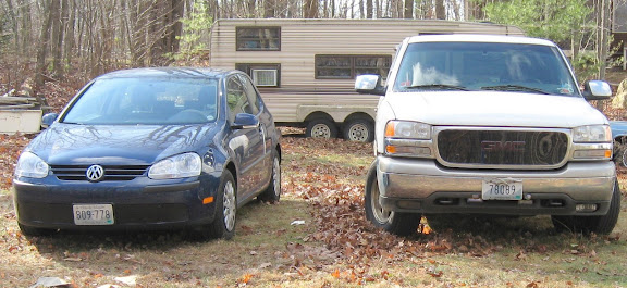

100% grille blocking on my GMC and VW:
https://lh5.ggpht.com/_oNsRR_T1Qx0/SS...6/IMG_2108.JPG The VW's upper grille blocking was done behind the grille. |
How's that 100% block on your truck effecting the a/c now that summer is here? I was not pleased when I only had one 4" hole in mine, so I cut a second one in there.
I took it off in the winter when my transmission was getting too hot. I don't drive the truck much in the summer so I haven't bothered re-doing the grille block.

Grille blocking differs from one car to the next. On both my VW and my GMC, I could block off 100% of the radiator or the grille and the engine temperature was not affected (but the GMC's automatic transmission fluid temperature went way up).
User maximilian talked about grille blocking with his Accent here: https://www.gassavers.org/showthread.php?t=10437 You might want to post in his thread asking if he ever did it and how it affected his temperature. He did try taping off the entire upper grille and did not experience any temperature increase, but the lower grille is probably where most of your cooling and aerodynamic drag comes from. As for the ScanGauge, if you've got some kind of fuel rate or fuel economy display then it might not pay for itself. It's a great tool and a great toy for anyone interested in cars. Some of its other functions can be had less expensively (a code scanner/clearer and a hacky DIY fuel rate meter can be had for investments of $40/each). If you don't have any realtime fuel economy or fuel rate display then it will easily pay for itself by teaching you about your car and your roads. |
