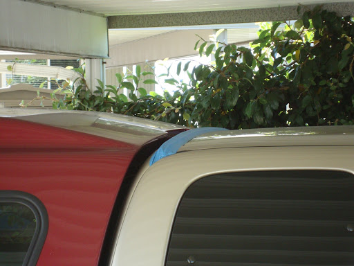

Poor guy's Air Deflector:

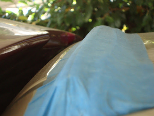

https://lh6.ggpht.com/_4xQFBZJE2fI/Sl...2/DSC00307.JPG Air would hug the roof and go down between the cab and shell, creating a horrible din. As you can see, the air now flows over the gap. https://lh4.ggpht.com/_4xQFBZJE2fI/Sl...2/DSC00308.JPG You can see how the cab aerodynamics work against streamlining. https://lh3.ggpht.com/_4xQFBZJE2fI/Sl...2/DSC00311.JPG Two different size of hose held in place with 3M Painters Tape. Rain hasn't bothered the tape used in this temporary experiment I did a year ago. |
