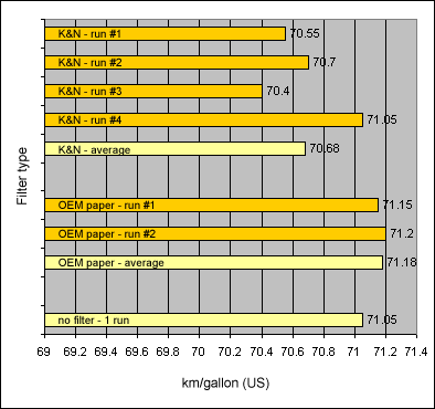

More tests like that, from my meta-sig:
Air filters tested -- paper vs. K&N vs. other brands, and so on:
http://bobistheoilguy.com/airfilter/airtest1.htm
More on K&N air filters:
http://www.gassavers.org/showthread.php?t=6808&page=2
http://www.metrompg.com/posts/air-filter-part-2.htm
http://www.metrompg.com/posts/photos/ACFBF2A.gif
It turns out that even a clogged air filter won't effect fuel economy.
http://www.fueleconomy.gov/feg/maintain.shtml
http://www.fueleconomy.gov/feg/pdfs/...02_26_2009.pdf
Another similar test: http://www.autospeed.co.nz/cms/A_111486/article.html
