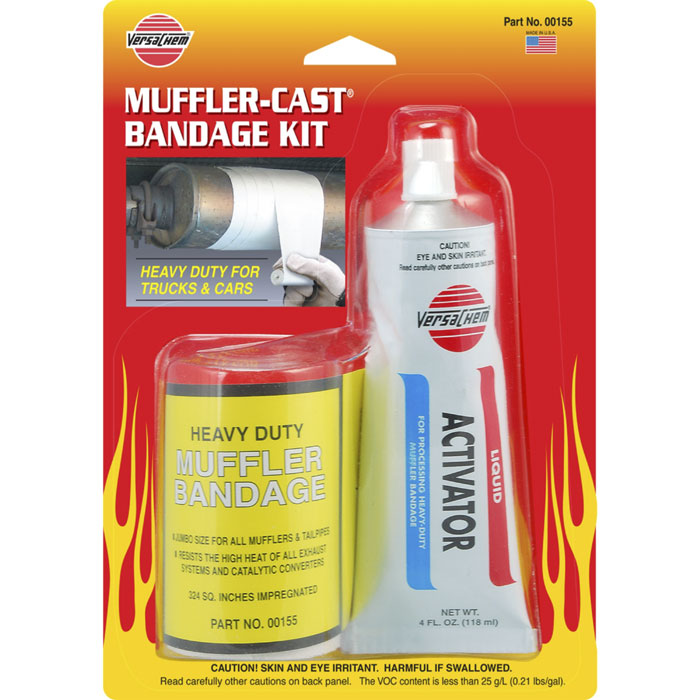

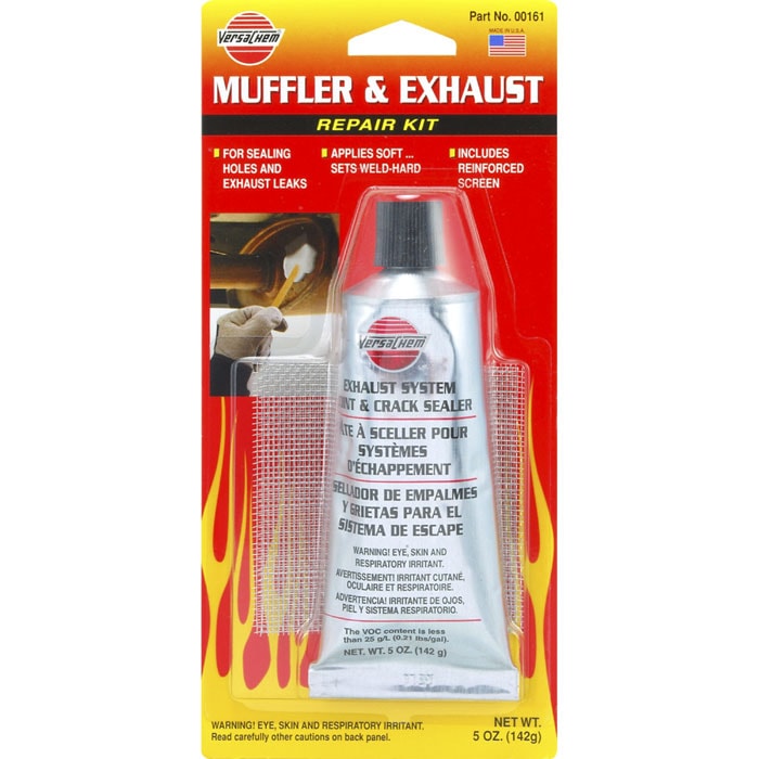

I do have a couple tubes of muffler bandage stuff, they're packaged with additional material (one with metal mesh, another with a roll of what looks like actual bandage) but they might be the same stuff anyway.
Actually, the one on the left is sold without the metal mesh material too, as "Joint & Crack seal".

Yeah- that's the muffler patch. I mix in some fiberglass insulation to give mine more strength.
