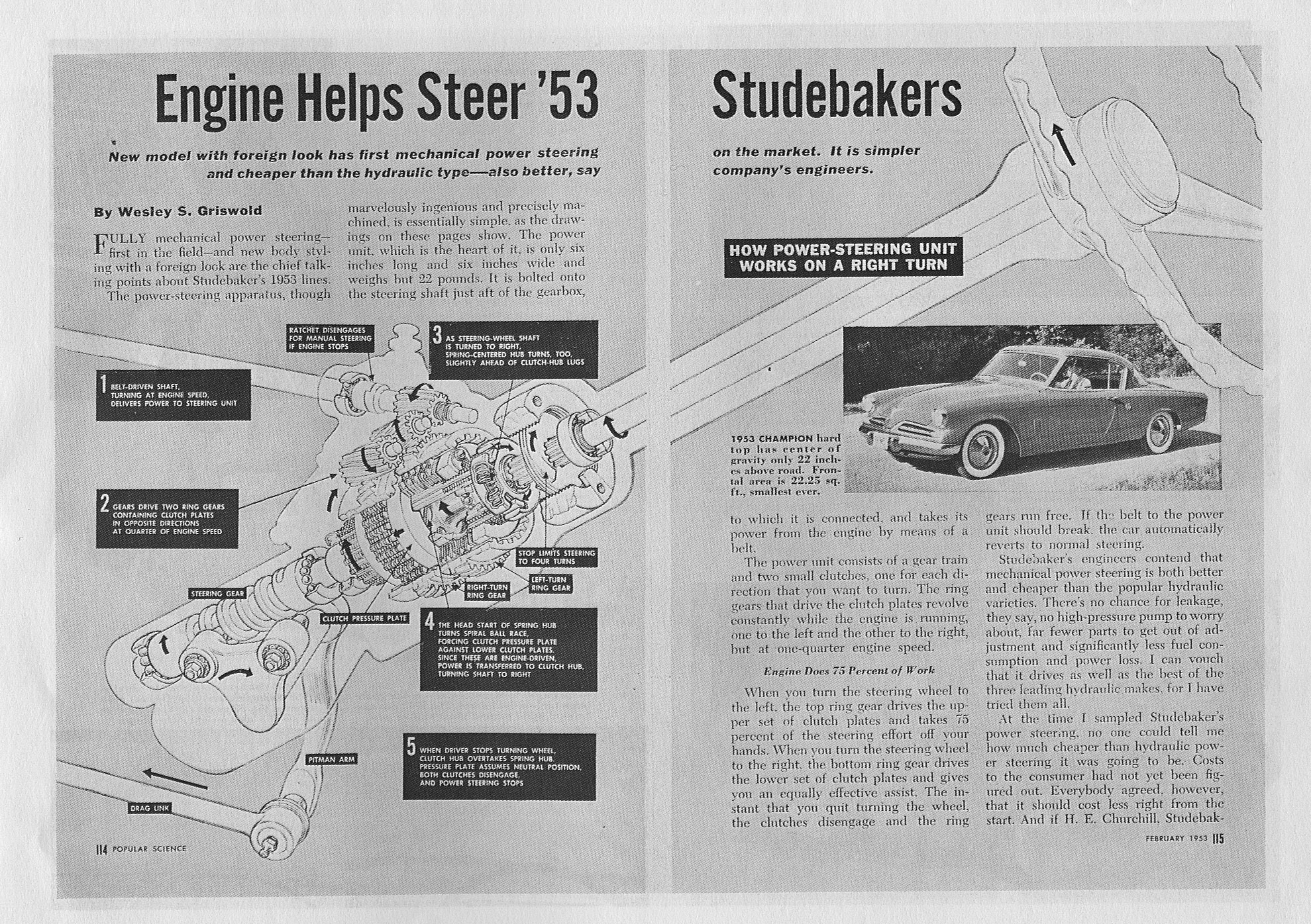

Actually, it is apparently common on diesel cars without a throttle plate, and therefore insufficient vacuum to operate a power brake booster.
Now...for something completely different...Mechanical power steering (NOT hydraulic!)
http://www.studebaker-info.org/tech/...s/53mechps.jpg
