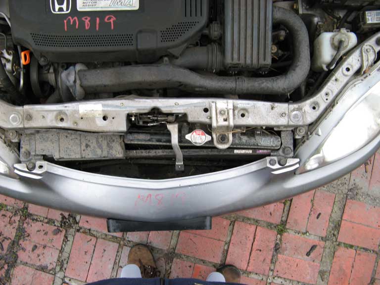

Pretty much spent today going whatever I could without having to actually unbolting anything. So far, body wise here is what I've got.
-Register and get it inspected
-New battery. Have a Wally World special the Heep killed a while ago. Its still under warrenty so I might be able to get them to swap it for a Civic sized one. Ryland, while I could get a high end one from somewhere for batteries I think its easier to get them local in case they need to be warrantied or something.
-Vacuum and wash the entire interior. Who ever owned it before me either drove with a dog or was in the process of becoming really really bald.
-Replace the drivers side quarter panel window
-Dent on passenger side, right above rear wheel cover
-Drivers side door lock is either destroyed or unhooked.
-Hood lock is jacked up. It doesn't look broken, but its loose. Bolt it down and I think it should be fine.
-Replace the front tow hook cover and get a replacement hook
-Replace the front drivers side engine cover
-New lift gate struts for the rear. The hatch is exceedingly heavy.
-Fix the rad support bar. Right now I'm trying to figure out whether or not its worth pulling this out. I think I could just leave it.
-Figure out what version BCM and MCM its got.
-Do the head light recall.
-Oil Change
-Coolant
-Figure out why the brake light is still on
-Derustify the front brake rotors
And that should be a good start :P

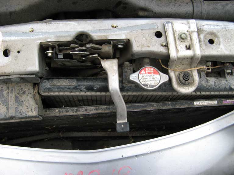

#1 - the hood problem you mentioned. Common problem. Clean and grease the latch up good - the problem is the cable. I'm not sure if they stretch of what but I used to have to push the handle back in while the hood was in the up position then drop the hood shut. It would normally latch.
