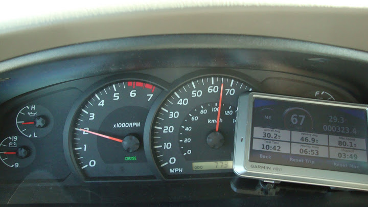

Set the cruise, so I'd have lots of time to verify the speedometer against the GPS and at 5 mile increments from 25 MPH through 70 MPH, the difference was 2 MPH.
I think I'm safe thinking that the truck now is 2 MPH faster than the speedometer reads. No problem learning to set the cruise differently. I'll learn to live the lie that I really went further than the odometer says.

The math is easy. Just adjust the miles before you compute MPG. Since you only bought 4, you can still do a rollout test with weight on the truck; put the spare on and measure tire circumference on both sides of that axle by rolling it until you get exactly one revolution (use paint or whatever you want to make it easy). You can get the percentage difference and adjust your mile by that percentage.
Less effort and more accuracy, though, would come from just using the GPS. Reset its trip odometer and your truck's trip odometer in the morning then check them at the end of the day.

I tried the GPS, but I have to get in touch with Garmin and ask how accurate the odometer is. I have the newest software and maps but I don't completely trust it because it used to be way different than the truck odometer before I got the new tires.
