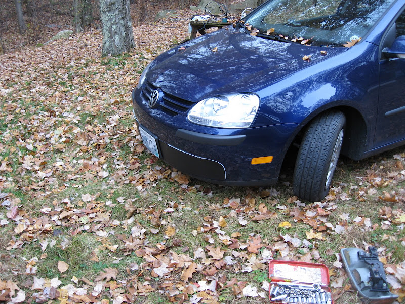

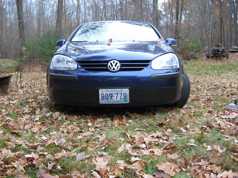

I spent the evening blocking my non-functional fog grilles (and a small amount of the functional grille). It sucks and I'm probably going to tear it off in the morning before I drive to work.
I cut Coroplast to shape and then curved straight pieces of coroplast wire frames to make it match the curve of the front end. https://lh6.ggpht.com/ronanian/SJES73...8/IMG_1568.JPG https://lh5.ggpht.com/ronanian/SJETBk...8/IMG_1570.JPG Here's what the car looks like without them: https://lh6.ggpht.com/ronanian/SJETLa...6/IMG_1572.JPG Here's the filler that goes between the grille and the coroplast to make it nearly flush: https://lh4.ggpht.com/ronanian/SJETG0...6/IMG_1571.JPG Here's one installed after I had attempted to match the car's blue. It looks pretty decent in this pic but it really doesn't look as good IRL. https://lh6.ggpht.com/ronanian/SJETQI...6/IMG_1576.JPG Here's them both installed after painting them black and clearcoating them. I overdid the clearcoat, so the black, which was pretty decent, got really blotchy. Also, I didn't get them flush like I wanted. https://lh3.ggpht.com/ronanian/SJETTh...6/IMG_1579.JPG |

Ok, here's what it looks like in the daylight. The white blotches are thick clearcoat on top of otherwise decent black. The lines are where the metal wires are, which looks terrible in daylight...definitely going to need to laminate another layer on there.
https://lh6.ggpht.com/ronanian/SJG2gy...6/IMG_1582.jpg |

Indeed, the car's design won't cooperate. Take a look:
https://lh5.ggpht.com/ronanian/SF1pWk...6/IMG_1314.JPG https://lh4.ggpht.com/ronanian/SJI-sV...6/IMG_1293.JPG https://lh6.ggpht.com/ronanian/SJI-wq...6/IMG_1294.JPG https://lh4.ggpht.com/ronanian/SJI-0p...6/IMG_1295.JPG I'm just not confident that I could do it in an inconspicuous way. Edit: Additionally, the last gap is between the grille and the hood and there's probably nothing I can do about that one. |

I got some time to work on it today. I cut another layer of Coroplast and tried to laminate it with hot melt glue. I used spring clamps to hold it to the curved piece until the glue hardens but it failed a few minutes after I removed the clamps.
So, I made some hairpin-like bends out of the wire frame material and stuck them in the ends to hold the two pieces together. Works great, and a couple hammer taps set them deep so they don't stick out of the edge. At this point, I'd like to take a moment to go off on a tangent rant. Lots of people hate cheap tools as found at discount stores, Harbor Freight, Cummins Tool, etc...but I really got this done a whole lot easier and faster for having lots of cheap specialty tools instead of just having an expensive set of common tools. Heavy duty multi-purpose fence pliers are great for this, and having a couple sizes of bolt cutters is nice because I've got just the right size to do this efficiently. I could have struggled with Snap-On vise grips and electricians pliers but this was a much faster and more pleasant job. Ok, I digress. I got the second layer laminated on, and the third layer (which I expect to be the visible layer) patterned much more neatly than the previous layers -- I even sacrificed a piece of material just for making the pattern. I made a whole extra set of "hairpins" for attaching them, too. |
It's getting less ugly. We have a nice 60 degree November day (I love that global warming!) and I took the day off because I had a rare chance to (usually I just can't even though I've got loads of vacation time built up).
Test-fitting what I think are the final cuts: https://lh3.ggpht.com/_oNsRR_T1Qx0/SR...0/IMG_1986.JPG https://lh3.ggpht.com/_oNsRR_T1Qx0/SR...0/IMG_1988.JPG I'm now putting coats of Plasti-Dip spray on them and then maybe tomorrow or this weekend I'll be able to mount them. They fit pretty tight, so I've decided that I'll pad any empty space with styrofoam (as I thought before) and then just face-screw them into the grille. That ought to be good enough if I place my screws neatly. I could also wrap the edges with some trim, such as door edge protectors, but I think it will be acceptable without doing that. I also entirely removed the grille assembly from the truck and now I'll be able to work on that indoors when it's cold and dark out. |
