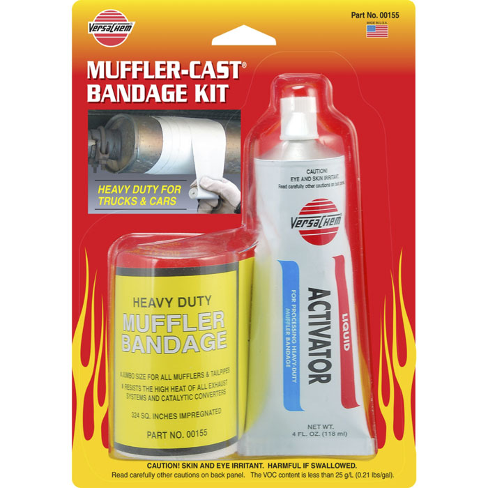

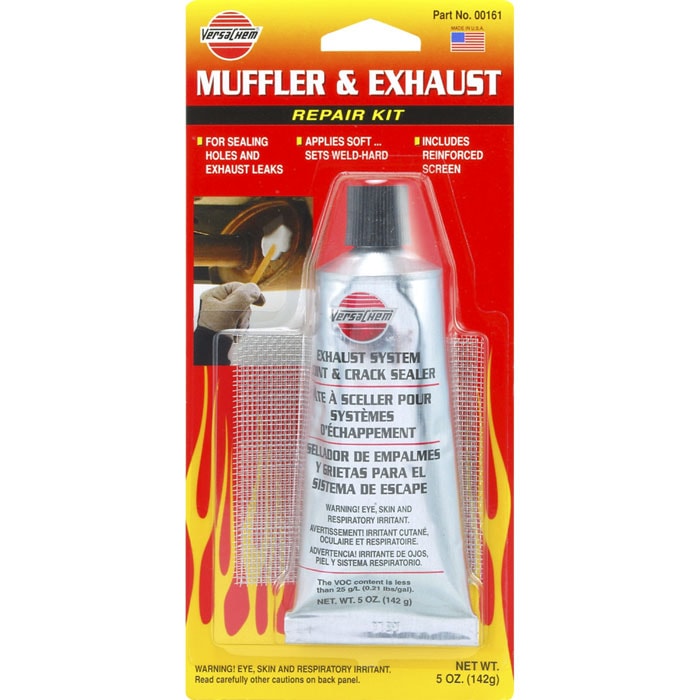

I do have a couple tubes of muffler bandage stuff, they're packaged with additional material (one with metal mesh, another with a roll of what looks like actual bandage) but they might be the same stuff anyway. https://contentinfo.autozone.com/znet...00161/image/8/https://contentinfo.autozone.com/znet...00155/image/8/ Actually, the one on the left is sold without the metal mesh material too, as "Joint & Crack seal". Seafoam might be a good idea, it makes a lot of smoke when it burns, right? So I'd see where smoke comes out. Anything cheaper that will smoke without harming the engine? I'm not too worried about the viability of the car, but I am worried about paying for parts/supplies...money is in very short supply. The car has 36,000 miles and my grandfather bought it new, which makes it worth more to me than to others; it's also generally a car I really like driving, which also makes it worth more to me. |

Yeah- that's the muffler patch. I mix in some fiberglass insulation to give mine more strength.
