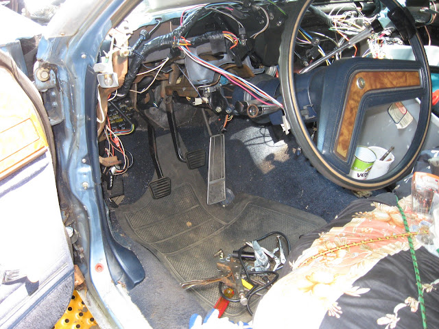

I have a 1980 Buick LeSabre Limited with a 4.1 liter V6. My grandfather bought it new. I got it 5 years ago with ~36,000 miles on it. For 4 years it has rotted in my yard because I couldn't afford to insure a toy car. I would look longingly at it, wishing I could take it for a trip because I love driving it. Then I got an idea...the TH350 3 speed automatic means that it could never get practical fuel economy, even with the 2.73 rear end. However, with a 5 speed manual, it has a fighting chance of being hypermiled to some decent numbers. Cheap insurance and cheap parts could partly make up for the low FE, too. So, I struggled and learned a lot putting in a 5 speed manual from a Chevy S10. Miraculously I made it work. Seriously...it might not be a miracle for someone who knows what he's doing but it is for me. Soon I will replace my 2008 VW with my 1980 Buick for commuting 75 miles per day. I could post a million pictures but it doesn't matter. This car is ugly. It's going to be ugly for a long time. Here's some numbers: 3500 lbs curb weight (compare to my VW's 3000) 18 feet long 4.1 liters 125 hp @ 4000RPM (well, when it was new) (VW: 170) 200 ft-lb @ 2000RPM (see, that's not so bad) (VW: 177) 2.73 rear end with 205/75-15 tires Transmission: Borg Warner T5 1352-145, originally from a 1985 - 86 S10 2.5 L4 or 2.8 V6, although it came in a 1994 S10 2.2 that I bought as a donor vehicle. 1st: 3.76 2nd: 2.18 3rd: 1.42 4th: 1.00 (same as the TH350's 3rd was) 5th: 0.72 This picture is from a few years ago. It looks about the same now, just a little less shiny. https://lh4.ggpht.com/_oNsRR_T1Qx0/R-...0/IMG_0452.jpg I haven't remembered to get an interior photo since I got it running. I'll try to remember to get one tonight. So, here's one I took after I finally got the pedals into position. https://lh4.ggpht.com/_NUF7e4VZj88/TE...0/IMG_5021.JPG You can see the interior's current condition in this video. It's got a nasty sounding exhaust manifold leak. I know the carburetor isn't working right. Other than that it's functioning pretty well. [yt]1wxd6KIviRg[/yt] My first gaslog entry is pretty lame but it's not going to be great immediately...it's going to take some time to get it right. |

It's ugly up close but I won't argue that one too strongly. The video was mostly for a forum about manual transmissions so I aimed it to get my pedals in frame. |
