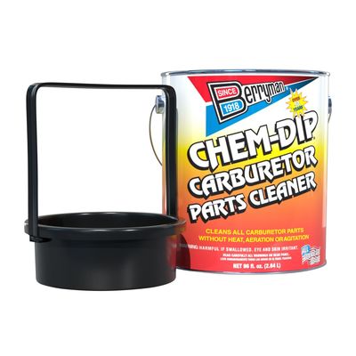

https://www.fuelly.com/attachments/fo...6f12ee5599.jpg Which carburetor dip? I've always known of Berryman Chem-Dip and that's what is mostly discussed on forums, but I stopped at the nearest parts store and they had Gunk Carb-Medic instead. I'd go with what I know works, except I've read that the Berryman product has been diluted sometime in the past few years due to regulations or lawsuits or something...and research indicates that the Berryman product that I can get is the California version. So, I don't know which works anymore. https://www.fuelly.com/attachments/fo...6ef43f9078.jpg vs. https://contentinfo.autozone.com/znet.../0996/image/4/ |
