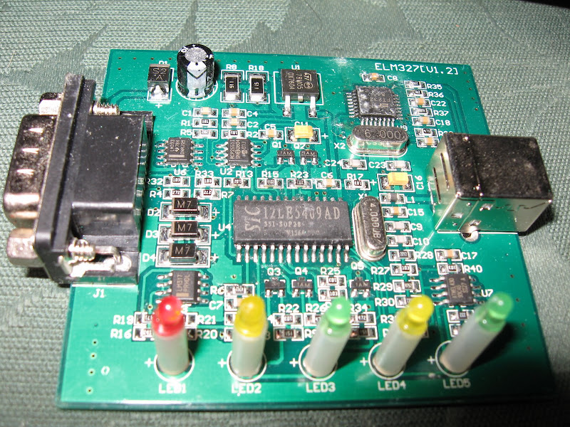

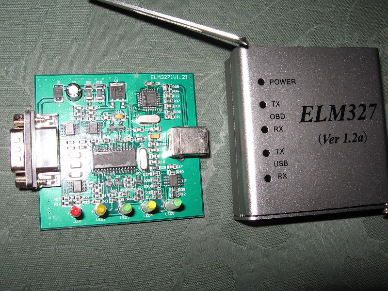

The closest I've seen for the OBD2 scanner was the common Chinese unit based on a fake ELM327 sold on eBay for $30. I got one and it barely works with any software, doesn't work right, and only worked on one of three cars I tried it on. |
I was able to pick up a 327 scanner on ebay for about $22 with shipping. It works with all software I've found that supports the 327 chip. Some programs were a bit of a pain but it wasn't actually going into 327 mode.

It looks exactly like the cheap Chinese one on there for $28. I think that might be the one I own. What programs could you not get to work with it? I'll try them out! |
I only ever got two programs to even vaguely talk to it, and they weren't dependable.
Mine looks like this: https://i.ebayimg.com/21/!BOmgMwwBmk~...-skBVg~~_1.JPG Here's my own photos of its innards: https://lh6.ggpht.com/_SX8ccPdZj5c/Sj...0/IMG_1700.jpg https://lh6.ggpht.com/_SX8ccPdZj5c/Sj...0/IMG_1705.jpg |
