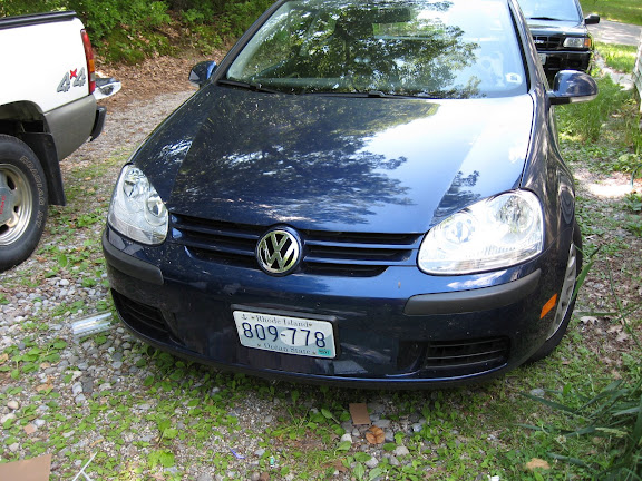

Well, in another thread recently someone mentioned using a temporary grille block to see how much blocking it can handle without putting in a lot of effort to make it pretty, and I thought it was a good idea. I just did full grille blocks on both vehicles.
I started by painting some coroplast and cardboard flat black.
In the truck, it was excessively easy, as if the truck was designed for it. I took a plastic cover off above the radiator, exposing the area between it and the grille. The A/C radiator is as big as the engine radiator, and has a triangular structural member a quarter inch in front of it running up the center. There's a lip near the bottom edge and lip-like items near each side. The transmission cooler is a couple inches in front of that structural member.
So, I slipped a piece of coroplast in, and it fit like a glove. I slipped in another one, leaving just a small portion uncovered; I used a piece of cardboard for that portion. One zip tie near the top corner of one piece of coroplast, and one zip tie in the cardboard, and everything is locked in place!
Edit: Ok, that wasn't very clear...the engine radiator is a couple inches behind the A/C radiator, so by blocking the entire A/C radiator I've blocked the entire engine radiator, but left a couple inches of air in-between. Also, this has not blocked the transmission cooler at all, nor a rusty tall narrow radiator that I can't identify.
Now, on to the VW. This was more difficult, and when I finished I realized that it was probably going to be a big failure. I cut a piece of cardboard big enough to fit everything.
It could not be accessed from the top, so I unscrewed 8 or 10 T25 screws that hold the bottom lip on. Then, with some experimentation, I found that I just had to pull it straight forward from the car to get it removed. I inserted the cardboard, and found that it fit snugly in front of the grille-exposed portion of radiator (but left some radiator exposed behind the bumper), and dropped it down into another convenient lip. Two zip ties in the bottom corners don't leave it completely immobile, the top could flap, but it should generally stay in place.
After doing it, I worried that I've overdone it and the car will overheat, but I just realized...I can very easily remove and reinstall the upper grille block pieces that I did in the spring. I'll expose some radiator there, and that will also allow flow into the area behind the bumper, which totals probably half the radiator's area. This could be ok.
Edit: The end result for both vehicles is a completely invisible grille block. In the car I can (hopefully) reach through the grille and tear the cardboard into bits to remove it. In the truck, I can remove it by popping a couple fasteners, cutting a single zip tie (or two), and pulling everything out -- it's so easy I could do it roadside in two minutes or less.
