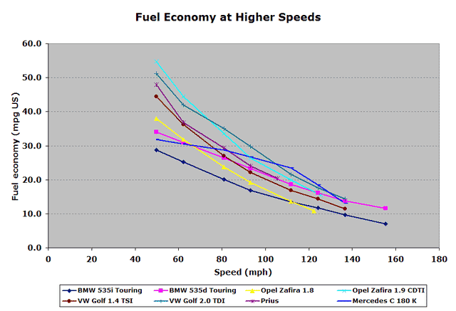

I've read that kind of claim a few times for different cars, and I'm skeptical. I wouldn't believe it without seeing controlled data (speed vs. FE), eg:
I get the sense that people saying that about their cars are deceiving themselves to justify driving faster.

The tC is a really aero sports car with 160hp engine and it may not get up to a good temperature until it is pushed a bit. Engine is probably not running efficiently at all at low speeds. I think it is smaller than my Geo was and more aero for sure. Guys were running Scangauges and took readings. I think they were drafting at the higher speeds without realizing it. The wake at 75mph is pretty far back and if there are enough big vehicles pushing the air ahead of you it can cover the entire highway and extend backwards for hundreds of feet. I watch the leaves on the road and look for which way they are moving.
MAN your graphs really tell the story! Wish I could find a long level road to take some readings at different speeds. Friend has a Honda Element and was drafting a bus at about 10 feet and getting 40mpg normally he gets 25mpg.
