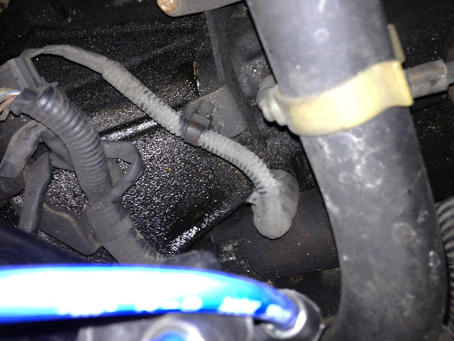

Coolant level and oil level have not changed at all over the course of 2300 miles. But now when I open the hood of the car I see a lot of oily fluid on the transmission. Also, the temp gauge climbed higher than it normally does for a short period after 135 mile drive to Brooklyn. Turning the heat on immediately brought it back to normal, but I shouldn't have to run the heat in the winter to keep my car at temp, no?! What if it was summer and hot and I was running the A/C? I'll upload a picture soon.

Take another pic farther back also. And change the thermostat I like to do that on all new to me autos unless I know when it was changed and spend the $ and get a good one you don't want it to fail and cook it right. My vx is about to go to speed for the winter. That looks like it came from the distributor but another pic please.

think my friend and I might have done a sloppy job when we changed the cap and rotor?

Go to sleep. Mine needs both axle seals it looks nothing like that. There is a little spray but it cant get up there. You Didn't do a sloppy job there is an oring in there. Doing the cap amd rotor onless you removed the dizzy lucky timing. Use some brake cleaner and clean it up and confirm. It's either the dist or the valve cover. Both are common. Over the winter I hope to new suspension bushings all around lower 1-2 inches belly pan new axles and seals. And finish adding intermittent wipers. Good luck.

It takes a very small amount of oil to make it look wet like that and I agree a thermostat needs checking or you have an air pocket in your cooling system. Test the thermostat in a pan of boiling water with a cooking thermometer and watch when it opens, even new ones may open at the wrong temperature.

That little bit of mess shouldn't be enough to worry about, IMO...but the overheating is definitely a concern.
