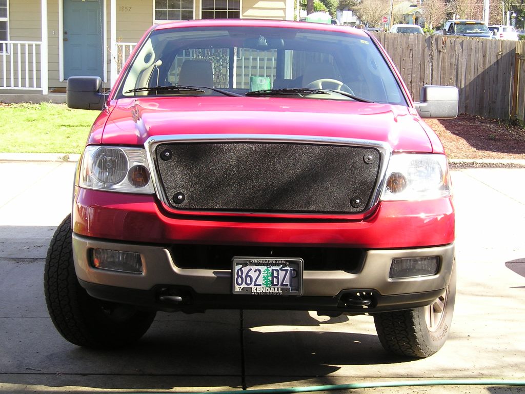

After reading a bunch of the lunatic ramblings of others here about how well grille blocks work, I've decided to dive into the experimentation myself.
So far I haven't done any efficiency testing, but I've completed an ABS block-off that completely covers the upper grille opening. I'm not really concerned about overheating until temperatures climb near the 80 degree mark, and a couple of short drives in 60 degree weather today confirm that it's likely not going to be an issue even then unless we are towing or climbing allot.
I think it actually looks fairly decent too. I'll post some pictures tommorrow and will hopefully be able to report some highway results.
If nothing else, perhaps the interior of the truck will simply heat up faster on cold days.

Anyway, here's a pic:

What is the grill block made of? It looks like anti-static stuff or black textured plastic to me. I like the textured look on the nose of the truck.

The blockoff is 1/8" ABS. The stuff is really durable and easy to work with, plus it's the same material that other textured plastics, such as the mirror housings and bedcaps, are made of.
Preliminary testing this afternoon is a bit inconclusive, but hints at an improvement.
Over a 20 mile loop run back to back at 60 MPH with the cruise control set, first with the blockoff, then without, the end result was 22.1 mpg vs. 21.9 mpg as indicated by the in-dash display. Better more than less I suppose.

The truck was fully warmed up before testing, and ambient temperature was 62F with dry roads, no lights or AC. The only real variables were traffic and filtered sunlight. I believe I was able to avoid any draft advantage by going 5 mph under the speed limit, limiting the amount of time other merging vehicles spent in front of me.
Unfortunately I didn't have time to repeat the tests to better define the margin of error, but I'm liking the 0.7 mpg difference that the leg 1 results suggest. If the leg 2 results are the worst of my margin for error, that 0.7 mpg is a 3.68% improvement. Obviously if the best case is reflected by the overall average, it's a mere .91% improvement.

Snax, did you also block off the openings in the bumper, below the grill. In order to get the benefit, I believe those need to be blocked off, also. In any case, on mine I blocked those off, as well and then added some holes, to keep the temperatures at normal, as necessary.
I wonder if it might make a difference how much clearance their is under a vehicle, on how much of an affect the grill block will have. It seems like under a F150 their is so much volume of space, that maybe it makes a less noticeable difference than on something lower to the ground?
