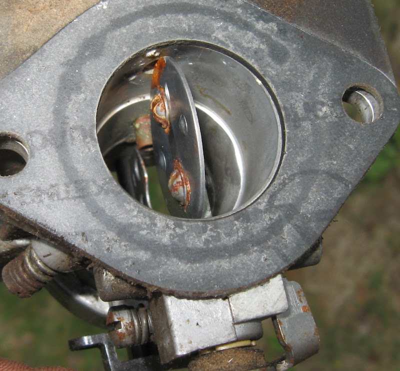

A bunch of corrosion in the carburetor...
The float needle is corroded, and the seat is corroded badly. How is the seat removed? Can I wirebrush/sand the corrosion or do I need to replace this stuff?

Underside of carburetor with bowl/float removed (see all the corrosion on the needle seat and such):
Corrosion visible on the, uhh, main jet I guess...and what's with what looks like smoke marks around the throttle pivot? I don't think it was backfiring through the intake or I'd see it on the intake pipe which is clean as a whistle.

Where do I go from here? Try to clean up the corrosion? Replace needle and seat? Replace the whole carburetor?

Just clean it all up and slap it together. Use carb cleaner or solvent. Don't let it sit with old gas over the winter next time. Looks like it got awful damp.

I think a rubber tipped needle will work fine in that seat. Just wrap a nail tip with extra five sandpaper and give it a few turns in the seat.

yea might need a stiff small brush to clean that after you spray it with carb cleaner.
the needle looks like it needs replaced. but could try cleaning first.
i must say i have never seen green corosion in a carb...and we let gas sit all winter in our mowers....start right up in the spring too....
could be extreme moisture.

So, I should buy a new needle and try to smooth the seat?

Unless you have a rubber tipped needle, you'd need a very fine finish on the needle / seat to make a seal, right? That rules out scratching it up too much during cleaning. Personally I'm cheaper than I am lazy: try cleaning it and see if it leaks.

That needle is rubber, right? Either that or it's got weird colored corrosion on it!
